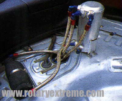

I was at a track day this weekend and when cornering hard to the right with less than 1/3 of a tank induced a momentary sputter or in my case the thing shut completly off as I was entering the next corner! I almost used the STI as a high speed lawn mower.
Mrt does sell a surge tank if you are in my position I think it would be a worthy mod. Check there site it is 1/3 the way down on the subi page.
