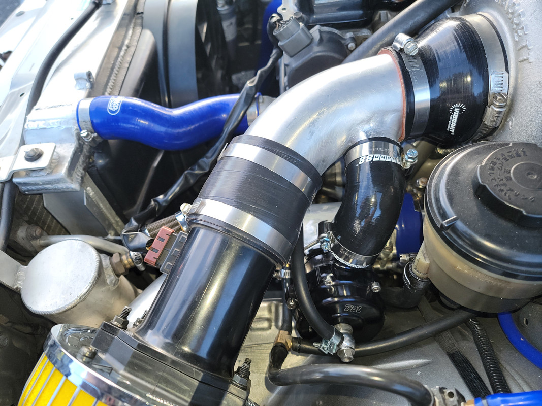

A bypass may be used to conserve kinetic energy and improve turbo response (reduce turbo lag). To do this, route the bypass back into the intake to the compressor wheel as the OEM does on all turbo engines. Whether there is a maf or not has nothing to do with this. The principle is simple: the compressor wheel imparts kinetic energy to gas molecules, and by re-directing these gas molecules into the compressor wheel we can conserve that energy, as opposed to letting it go with an atmospheric bypass. It will alter the pressure ratio and improve compressor map outlook. This will enhance compressor wheel performance, as faster moving gas molecules coming in reduce the stress and counter torque applied to the wheel which will increase wheel velocity overall.
Here is a picture of what I am talking about

-Bypass setting and maf placement are 'tuned' features of the engine, just like tuning an ECU these must be tuned for the combination. There is no one size fits all solution, no best bypass brand or setting, no perfect maf location. You must watch wideband and listen for surge.
-All turbo engines must be pressure tested. Leaking air from plumbing causes high EGT, high EGP, high IAT, and may lead to engine failure due to high IAT and EGT. It can also overspeed turbo and explode the turbo into pieces.
-Careful Recirculation of bypass is a performance improving modification when done properly.
